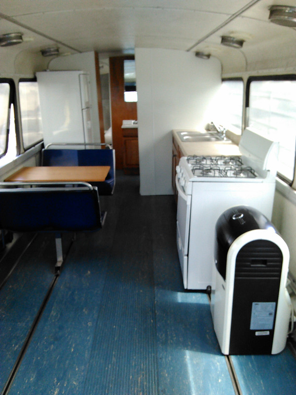

I've done both. In my MCI 9 I used household appliances--big frig and re-jetted for propane natural gas stove and oven. In my little Superior I went with the drop in miniaturized propane stove/oven and a small under counter 120v frig. Both work well in their respective applications.
I based my decision purely on available real estate. Both provide the same general creature comforts. Of course I can only roast a 5 pound chicken in the little bus whereas a 14 pound turkey would be no problem in the MCI.
