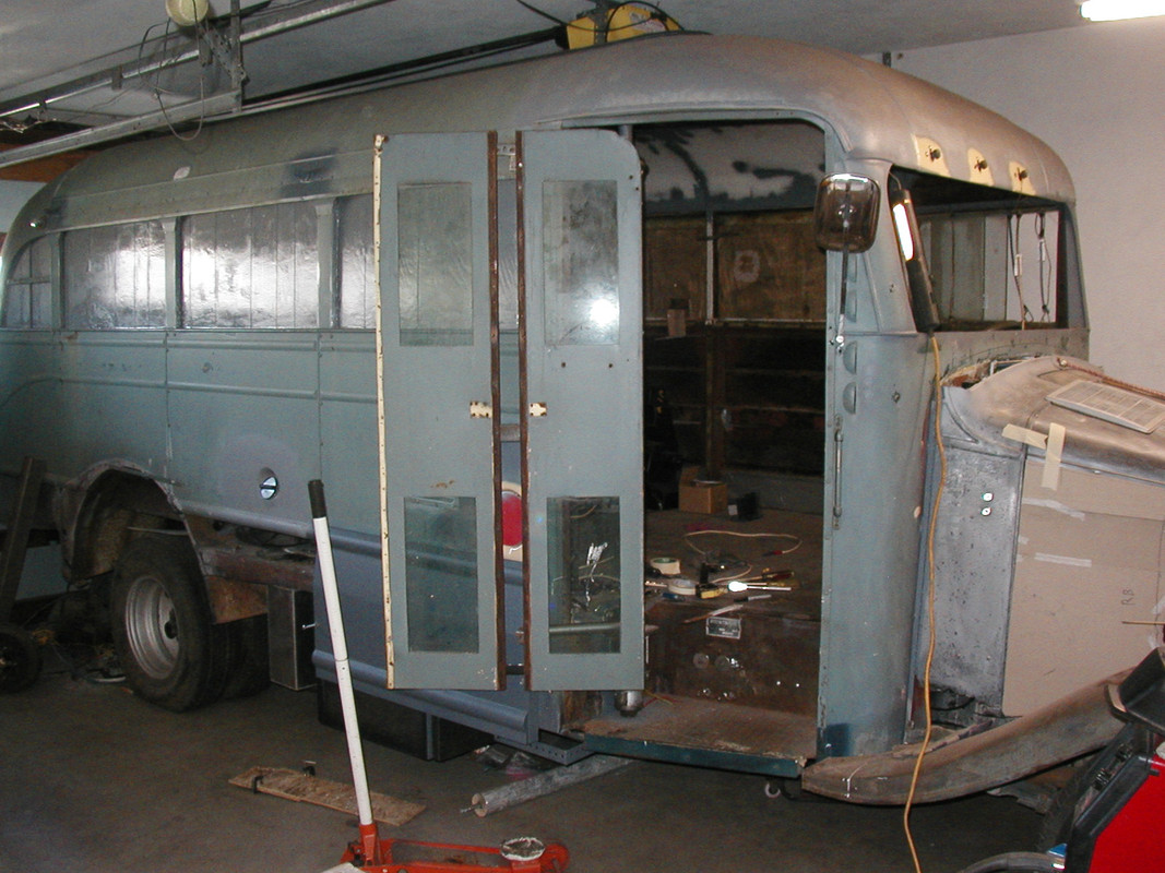

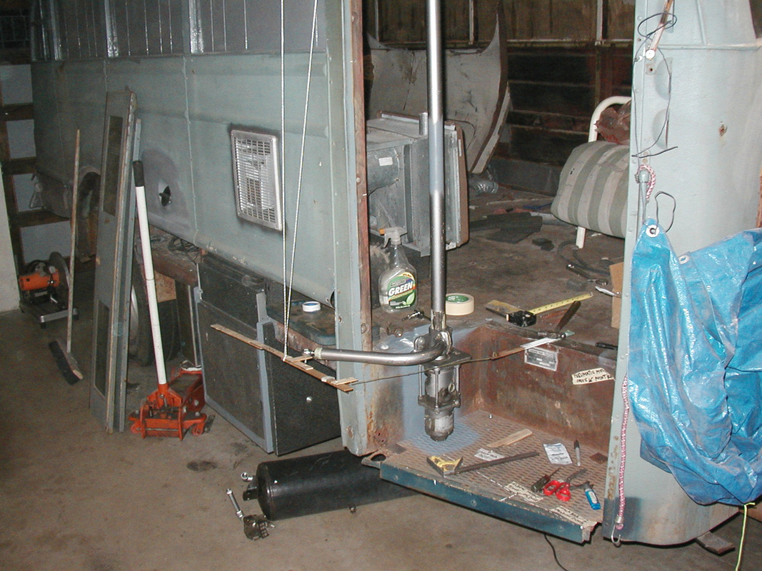

I wanted to keep the look of the original door so I welded the bifold together, added some 1/8" plate around the edges and center and hung the thing on a pneumatic shuttle bus mechanism. I could have mounted it on standard hinges and it would have worked/looked about the same. Jack
