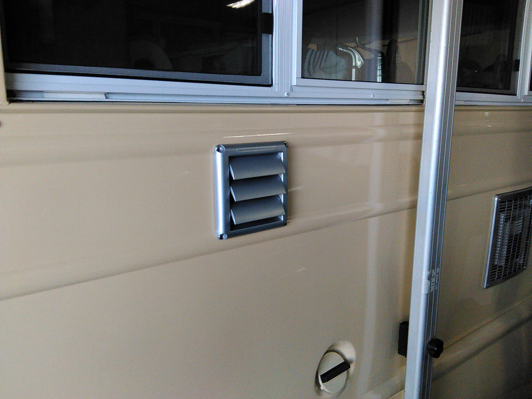

Wow, you are not messing around.. looks great..does that fridge has a separate condenser, or is it in the walls?
With the freezer so close to the roof it might be good to put some extra insulation there if possible.
Johan

The condenser is contained, and it seems to radiate from the back only. I don’t seem to discern clear convection channels. I need to investigate deeper with an IR thermometer when things are less busy.
There’s about 6” above the freezer and I am trying to figure out if it is more energy efficient to put some ducted fan system on top to pull the heat out in some controlled manner. And add/remove insulation accordingly. I’m not sure yet exactly how.

I put in a temp controlled heat exhaust fan behind my frig. It cut the run time by about 33%. The fan is a large 12v computer fan. I also put a smaller fan aimed at the frig compressor that runs any time the frig is on. Almost free and other than the vent on the side of the bus well worth the effort.
