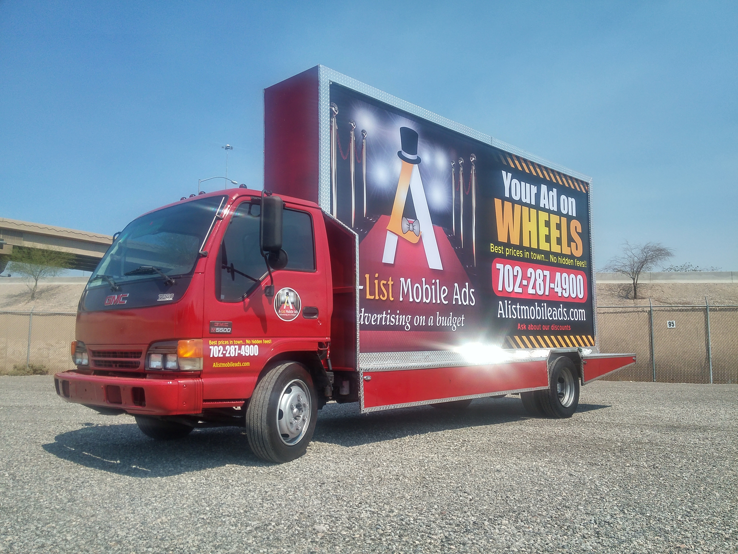

what ya gonna build with that?
Put a big two-sided electronic billboard on the back and drive around sacramento advertising Cannabis delivery services??
They have wads of venture capital cash and need exposure.
heck why not!! billboard trucks have been around for awhile I was thinking though of the longest-bed regular cab pickup truck known to man

Make it have sleeping quarters inside and solve the homeless problem, they can have job driving around billboards, and have one sleeping inside while another drives, moving 24x7, no legal problem of sleeping in parked cars. At 2am, change the advertising to Bail Bonds service. lol. That motorhome chassis was $1500, now it is $1000. I have a 68 Chevy C40 cab looking for a home.
