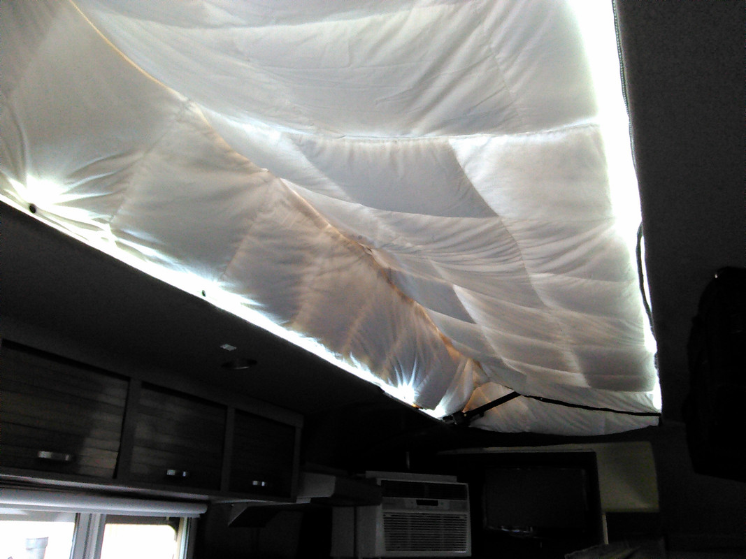

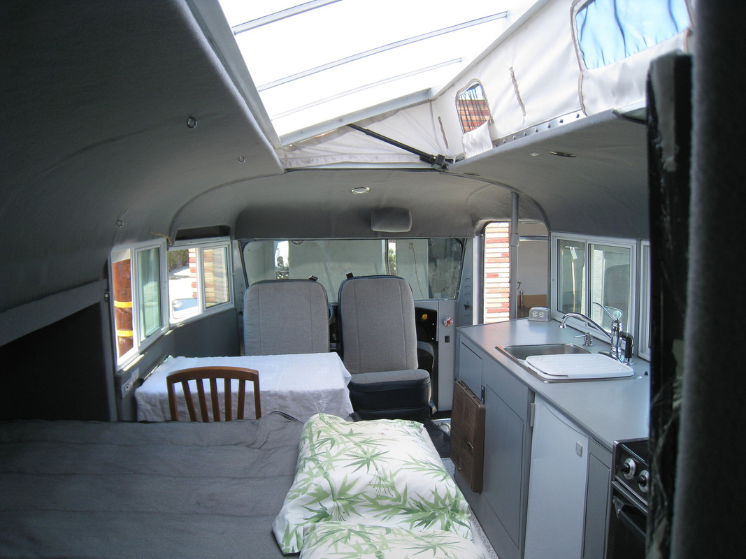

I ended up with a mix of inorganic and organic insulation. I have 2" of foam board in the walls, the under floor and as much of the roof as was possible. The balance of the roof is a combination of polycarbonate and tent material--pretty good at letting hot air out during the summer and also pretty good at letting hot air out in the winter I might add. Now for the organic stuff. I stitched up a heavy goose down comforter to match the contours of the pop up and suspended it with straps and snaps from it. Wifey is afraid to leave the propane heater on at night (what's a boy to do) so it's just the two of us heating up the tin can at night. Readings from my indoor/outdoor thermometer show that the comforter maintains the interior heat at ten degrees above what we were dealing with beforehand.
