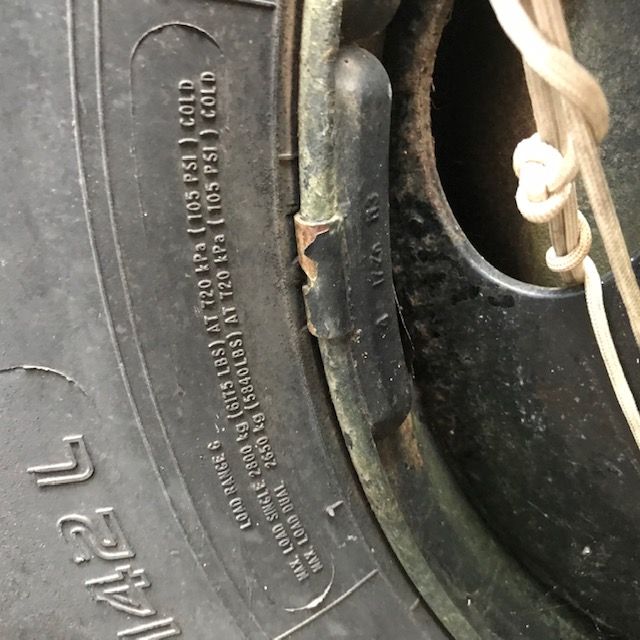

On the side of the tire.
Yes Its (Cold pressure) ON The side of the TIRE!!
