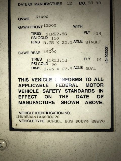

Do you have the VIN tag above the drivers seat?

My bus recommends front pressures 5psi higher than the tire max recommended psi. Rears are 15psi less than max tire pressure.
Then you have incorrect tires for the bus… the real tire pressure to use is achieved by weighing each axle at the cat scales … then reading the load chart for your specific tires and airing up based on that chart.
Most tire brands have similar load pressure ratings so if the expected pressure is over that of the tire limit buy new tires

I agree at a certain point there is no gain, only loss. Where is that point? On a specific tire? Mounted on a specific vehicle? With a specific load?
The tire pressure rating on the VIN tag is "ideal average", IMO. How can it be anything but that? I'm not talking airing up from 30 to 45 PSI or down to 20 for a comfortable ride. Just a bit of marginal difference. Maybe get 1MPH better. That adds up on a cross-country drive, though. I just put 6000 miles on in a month. What if I had saved 0.5MPG? At $3.20/gallon average? I got 9MPG going 70MPH on hills. What if I got 9.5MPG? $2133.33 vs $2021.05. Saved a hundred bucks there! Shoots, that's a good bag of buds! If I could get 10MPG, that would be $1920.
But I really don't know the real gains.
I know my bike tires say something like 50-75 PSI. I can REALLY feel the difference between the two, in how hard it is to pedal. but I don't think much more than 70 would make much of a difference.
My bus' front tire VIN-plate specs are 110PSI if I remember. No, haven't hit that diagonal edge and felt my bus loose control. Did I ever hit an edge like that? IDK, cause I never noticed! Maybe. Maybe not. Then again, any little bump throws the front of my bus in the air, so ..... Really gotta call BlueBird and see if they can get new front shocks to specs. Got Monroe Gas Magnum charged shocks on there now. No other options. The rears have Gabriel shocks that resist in and out movement. But I don't ride back there.
I keep my bus tires at vehicle spec (but that is near max on the front). My cars and trucks I always ran high, sometimes 5PSI or more. So call me crazy. But I live life on the edge quite often.

Match the tire to the rig based on the LOAD it must carry.
My bus is 31,800 GVWR but is unlikely to exceed 26,000.
I'll stick with the placard recommendation for tire size, load, and pressures (while not exceeding the tire max). I will however, reduce pressure off road and then air back up before hitting the highway.

Weigh each corner, then look up the recommended pressures in your tire manufacturer's chart of pressures. There really isn't any other way to do this.
