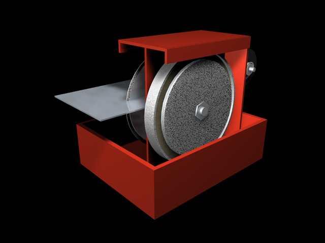

What I am trying to make is a couple simple machines for cutting and grinding/polishing glass bottles. I was thinking of using something like this with modification for tabletop and circular wet diamond saw blade (like a wet tile saw)with water tub underneath.

The second machine I need seems a bit trickier to me. I need a machine that rotates a diamond grinding disk in the horizontal position with a gravity fed water system. Similar to this but powered by treadle and flywheel like the above machine:
I need it to handle a 12" disk. Water feed seems pretty simple, a hose and valve to control dripping. I am more concerned with the conversion of energy from the vertical to the horizontal. Has anyone ever made anything like these? Suggestions? Ideas? Thoughts?
I am also considering a combination machine like this:
But I don't want to grind on the vertical if I can avoid it. It makes getting a parallel to bottom surface harder.
