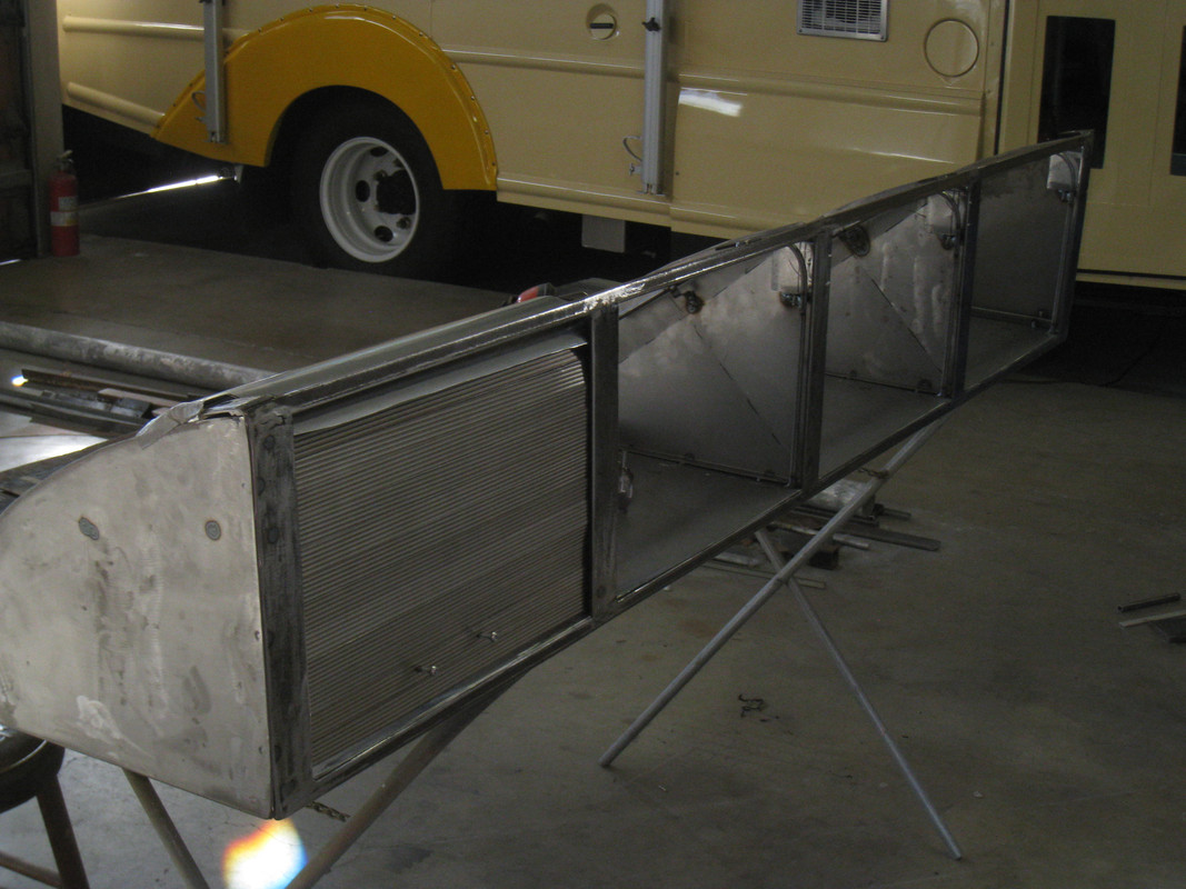

Like IJ, I hate wood. Therefore I made my kitchen cabinets out of metal. I welded 1/4" x 20 nuts to fender washers and then welded the assembly to the roof. Jack
They are beautiful! Yeah, way to go! Take care of function, then form will take care of itself.
